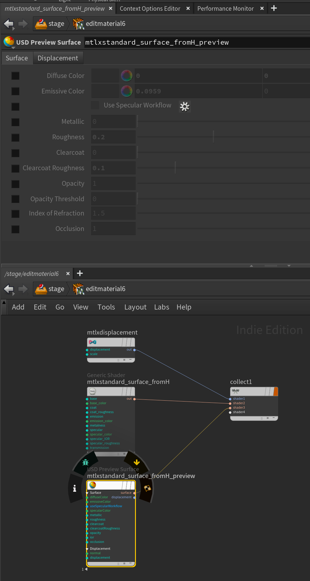

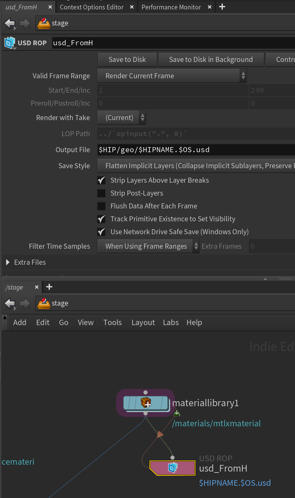

As an alternative test, I tried to export the Material Library containing the source Material X Standard surface & material to a USD file.
When I reference the USD file, and try to reconstruct it I end up with a Mtlx Displacement shader, a generic shader, and a USD Preview Surface VOP, each feeding into a collect VOP.
A little closer, but I expect a MtlX Standard Surface VOP, instead of a USD Preview Surface VOP.
