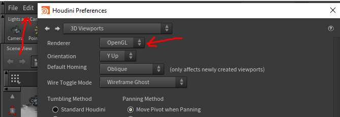

you probably are using Vulkan which is quite buggy as of 20.5, switch to openGL from top menubar "edit -> preferences -> 3D viewports -> Renderer" then test again.
Edited by AhmedHindy - Oct. 26, 2024 06:03:43

Yes, switching back to the OpenGL renderer is a good fallback for some new viewport issues
I would also try testing out a newer release, if that's possible
The newest production build is 20.5.370 and should include a fix for this issue, it looks like it was fixed in 20.5.238 specifically (typo, fix was in 20.5.328)
Edited by williambrown - Oct. 30, 2024 11:01:55

Sorry, typo, the fix was in build 20.5.328, not 238
