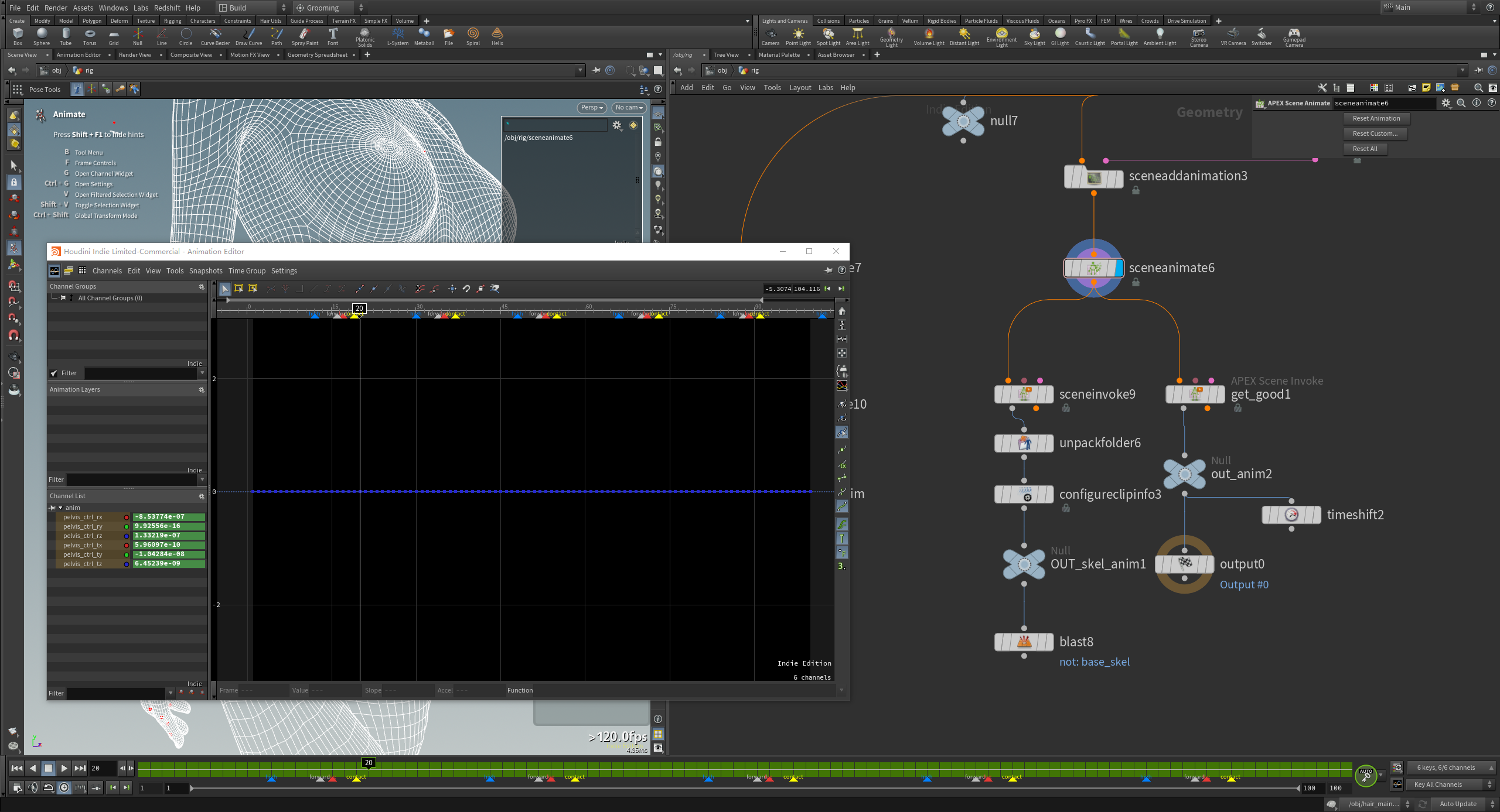

Hi guys~!
I have a character who captured the action library, and the APEX Scene Animate node baked the frames.
But in the animation editor, you can see the numerical changes, but you cannot see the fluctuations of the curve.
May I ask where the problem lies?

Those values look insanely small, not sure if it's possible to vertically zoom that far to see the difference, but they are likely insignificant so as good as 0

I was really stupid, I overlooked that this is scientific counting. Thank you for your reply~~!
