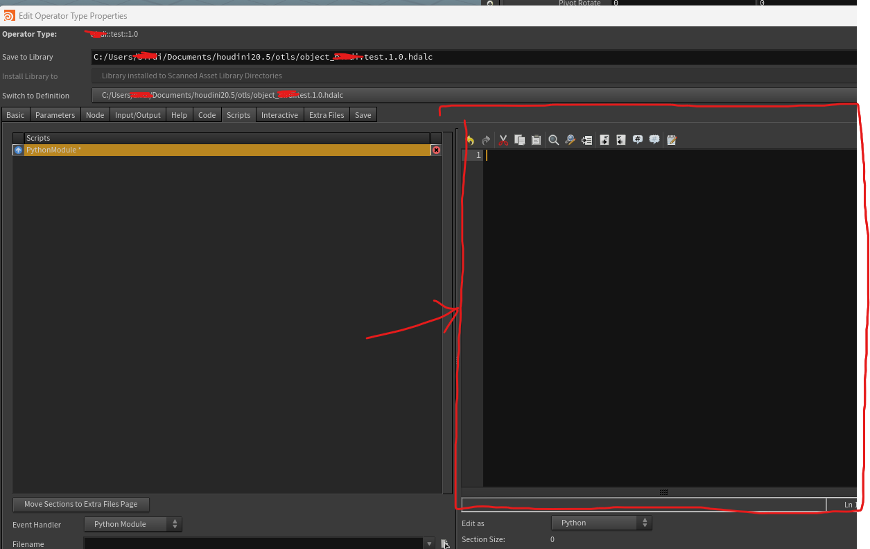

Hello everyone,
I am working on a script to create a HDA from the scratch using Python.
Now I want to work on the Scripts section of the HDA. I want to basically create a Python module and edit them later down the line.
I tried to look for information on this to no avail.
Dragging the HDA into the python shell + .asCode() didn't help either.
Any help or suggestions, or pointing me to the resources would be very appreciated.

The HDA Python Module is one of the Sections available in the HDADefinition:
Check the bottom of this doc page: https://www.sidefx.com/docs/houdini/hom/hou/HDAModule.html [www.sidefx.com]
myNode.type().definition().sections()["PythonModule"].setContents(myPythonCode)
