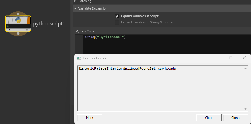

In TOPs after adding a “Wait For All” node and adding all the attributes to an array I have a really hard time accessing the values.
Does anyone know how I can print all the values in the array with a “pythonscript” node?

Can you show an example of what your network looks like?
Joined: July 2023
Hi Alex,
here are the steps:
find all the usd files
in wait for all I append the values to an array
now I have all the filenames in an array on one job
when I print the attribute it is not an array, but only prints the first value
I have tried:
item = work_item.stringAttribArray("`@filename`")
print( item )
but that doesn't seem to work either
