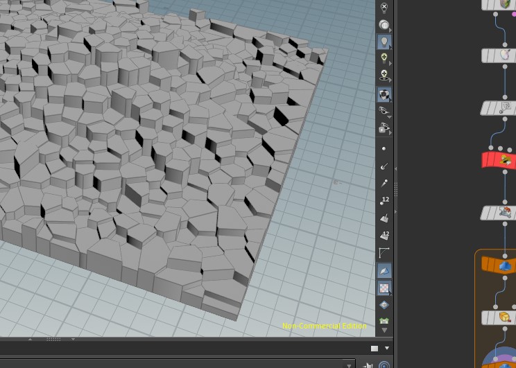

This is my first attempt that what I was trying to do with just a voronoi fracture
basalt initial test.jpg (85.4 KB)
17 posts
Joined: Jan. 2017
I looked at some other solutions that I found on artstation and integrated it with my needs and have a good start with this node combination.
