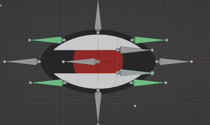

edwardSo would it be even possible to manipulate a texture with a controller on the rig, like on the photo(blender)?
The cop:: APEX nodes aren't really designed for manual usage because they require special setups that are automatically done for slapcomp in the Solaris viewer.
