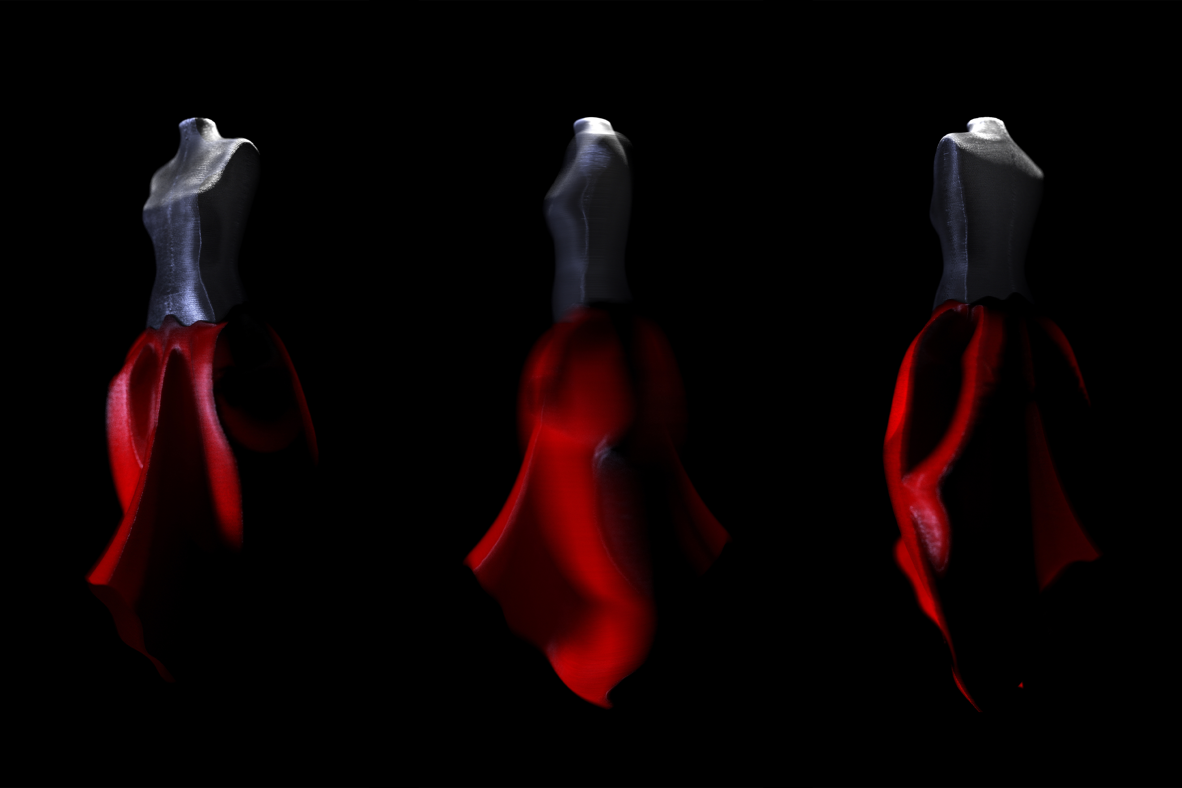

The process began with creating a procedural drape for a skirt. The model consisted of two pattern pieces: one for the front and one for the back. Each piece included a side seam and a guide curve at the waist to ensure the skirt positioned correctly on the mannequin. One key goal was to establish a PDG network, allowing for the visualization of numerous material configurations and gaining a better sense of how the skirt would naturally settle.
