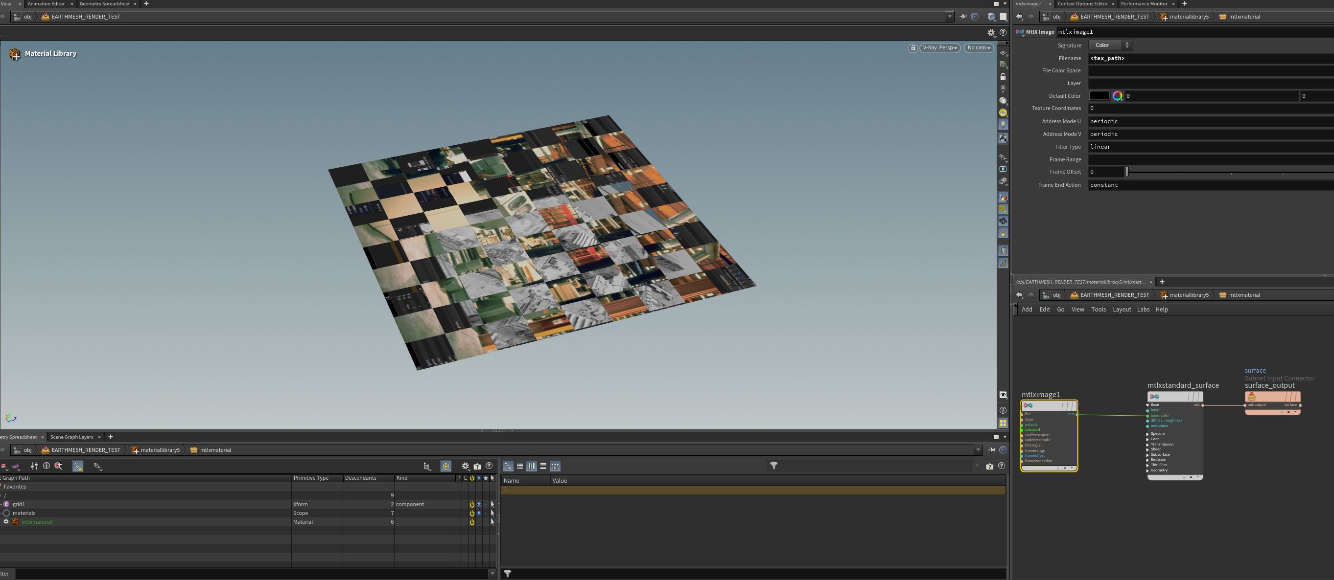

It is actually working with Vray using a very simple mtlxImage with a <tex_path> string attribute. Oddly the same MaterialX material fails in Karma.
In the example there are two textures on alternating prims.
54 posts
Joined: Dec. 2016
