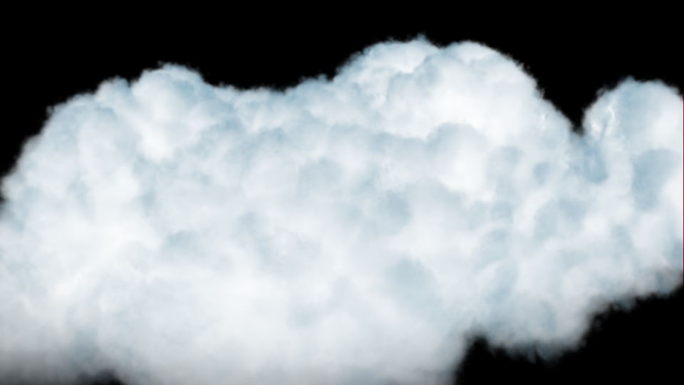

here is the firtst render with this workflow.
The balls of the main shape are to present for now and there is some strange little “ transparent” lines appaearing at the bottom of the cloud …
Vincent
http://vimeo.com/vbkstudio [vimeo.com]
66 posts
Joined: Sept. 2008
Cool, how did you manage with the SSS??
NicoZ
383 posts
Joined:
there is no sss
is a trick taken from a thread on odforce forum.
http://forums.odforce.net/index.php?/topic/12923-pyroclastic-noise-demystified/page__hl__pyroclastic__st__36 [forums.odforce.net]
I had the time for a last render
19 min on 6 threads of 3Ghz i7
It's a bit long IMO … and I am not able to get some nice godrays for the moment :cry:
