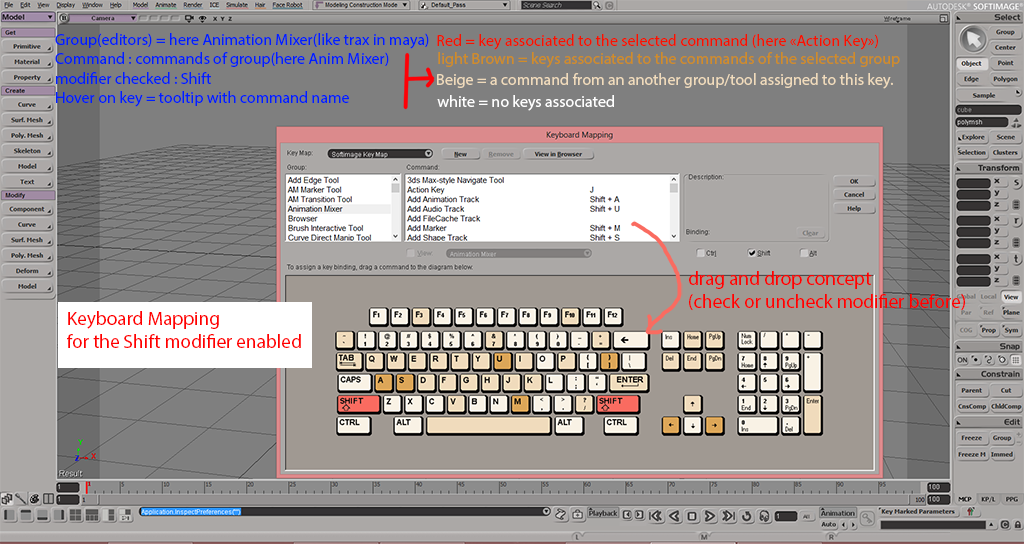

MartybNz,
Thank you for your suggestion regarding shortcuts, although I'm not sure I intend to model in Houdini more than necessary for testing (at least not until I fully adopt it and the modeling and interaction is improved).
Also, thank you for taking the time to read the page. Please make sure you read everything.
As for why is the scale tool bad design, I'm not sure what else I can say than I already said there. But still, to address your point directly, I have to say that the way it's currently implemented, you have to be very precise, much more than with the move tool which has the center thingy.
Cheers!
