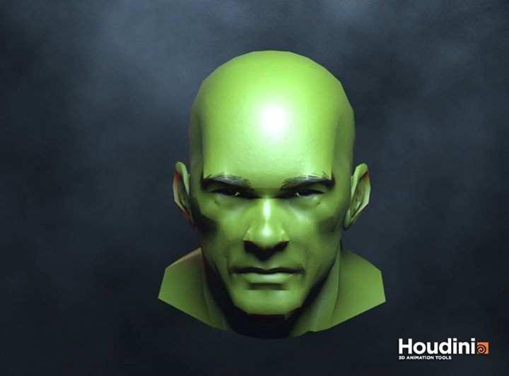

can you explain a little bit more one the “proper tweak” ?
a Tweak tool allows for quick translation, rotation or scaling of a point, edge or poly/s without having to swap through the component modes. It should work with a visual soft selection as well.
Have a look at this video…from about 3:15"
https://www.youtube.com/watch?v=cTc51DiVDeA [youtube.com]
- pelos
- 617 posts
- Joined: Aug. 2008
- Werner Ziemerink
- 1265 posts
- Joined: March 2014
I know about the soft selection in houdini. I used it to tweak this model, but it needs to be visual in the viewport.
The biggest slow down is the amount of keys you use before you can actualy tweak points (soft selections only works on points as far as I know).
1. Press S to go to selection mode.
2. Press 2 to activate points
3. Click and select a point
4. Press t to translate then swap to y t get combination
5. Press Enter to activate selection on any other point
a proper tweak tool should be 1 button to edit points, edges or polys. Just activate soft selection before you edit and off you go…much quicker. You can see in the network view the amount of nodes it took to creat a basic head model. It broke my wrists.
Edge slide(that works with soft selections) is another tool that is missing from the tool set.
Most of the other tools are awesome and work the way they should with extra control under properties.

Thanks, pusat. The node history is long, and Softimage or Smaya would chock on that amount of history. The scene is still realtime in Houdini.
I'm going to give your edge slide a go. Thank you very much.
Sliding in Softimage with proportional on, would slide the surface radius. I've attached an animated gif.
edward,
I have to hit Enter on the edit node to be able to do that. If I don't I have to select a new point first before I can translate it. If I hit Enter, it allows me to move other points without selecting them first.
edward,
