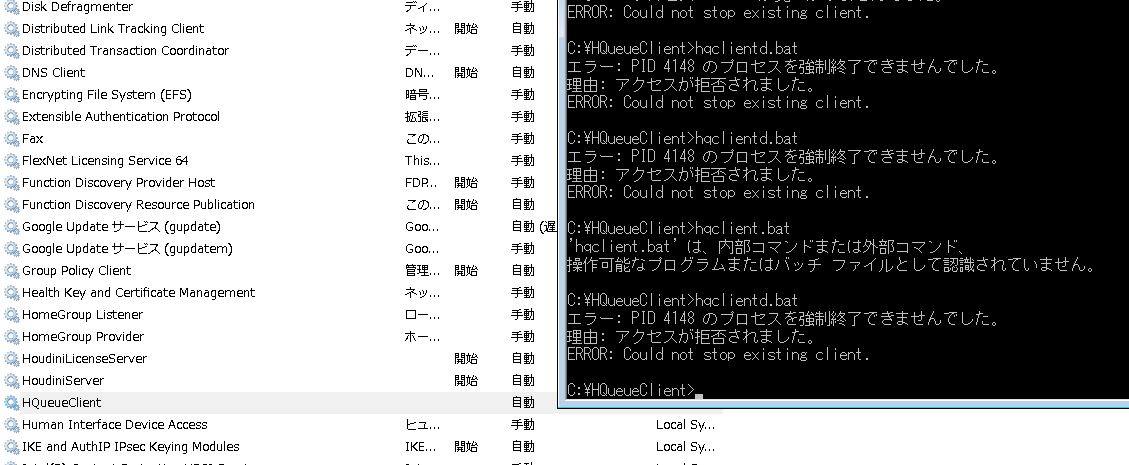

I am running all machines on Windows 7. I got HQ running on my local machine but it will only work if i copy the Project Files to the shared Folder and start the HQ ROP from there. Also this will only work for my local machine. As soon as I ad a client I will get an error which says for example:
“ERROR: Cannot open file KHoudini/network_test/network_test_02.hiplc”
This Error must be caused by the Permissions I guess but I can`t figure out how to fix this. I read a lot spreaded all throughout this form about chancel the HQClient Service and start hqclientd.bat instead if you run in permission errors but somehow I am not able to start the service manually.
Cmd Console will flicker up a second but will shutdown immediately without starting the client.

If you see an ‘Access is denied’ error early on in the job output then the HQueue Client could not access files on the shared folder. To fix this try changing the user account running the HQueue Client service to the Windows user account that you are logged in with.
Open the Windows Services window (Control Panel -> Administrative Tools -> Services) and locate the HQueue Client service in the list. RMB-click the service and choose Properties.
In the Properties dialog select the Log On tab and then select the “This account:” radio button. Change the user account and password to your Windows account and password. Click OK to save the changes and close the dialog.
Now RMB-click the HQueue Client service again and select Restart to restart the service.
If you still encounter an ‘Access is denied.’ error after this change then you can try the following workaround:
Run the HQueue client process outside of Windows services.
Stop the HQueue Client service (Control Panel -> Administrative Tools -> Services). Then start the HQueue Client process manually by opening the Windows File Explorer, navigating to C:\HQueueClient and double-clicking on the hqclientd.bat file.
Note that with this workaround you must manually start the HQueue Client every time you reboot the Windows machine.

Hi Luke,
thank you for Your reply!
Yes I did try to your suggestion with target hip but I get the same “Cannot open file” ERROR message.
I also tried to change the user account and password in the Service Options but it also gives me an error telling me that this user doesn`t exist which I know for sure it does.
I also tried stopping the Service manually and executing the hqclient.bat which also gives me an error in the cmd console telling me
ERROR: Could not stop existing client
I already stopped the running client service by myself though so I don`t understand the cause of this error.
Do You have any other ideas about how to fix this “Cannot open file” issue?
Best Regards
Dani
Perhaps I should mention that I use Windows in a Japanese environment maybe that is the cause of the errors?
Best Regards
Dani
