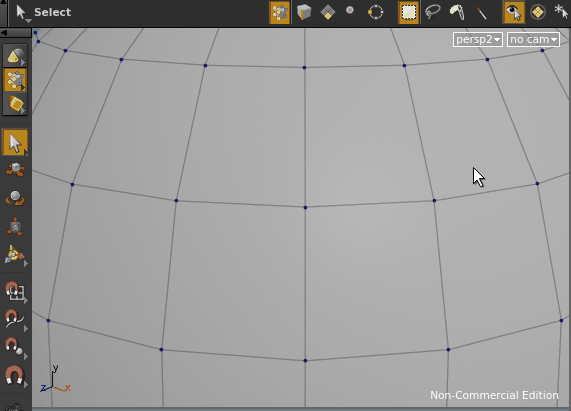

The main problem I'm having with the edit tool is that it is in tweak mode and in that only when having a transform tool active. That makes it impossible to select when zoomed in, as is often the case when detailing some small part of a mesh - it forces the user to either go in select mode or to zoom out to be able to drag select from outside the silhouette of the mesh if what you want to select is best suited for a box-selelction.
Proposed fix
Bring back the old mode of the edit node and make the current one a toggle:
I miss the old way of editing for its non-intrusiveness. Tweak mode is cool, a long awaited feature which will hopefully become great with a few enhancements (like picking a reference component on the fly, collapsing points, etc), but please let the user decide when to use it.
I've looked in the Hotkey editor and I didn't find an entry for those modes. They have to have a hotkey (by default or assigned by the user) for quickly accessing those modes.
What's your thoughts?

Best way I could find was to switch off poly selection. Not perfect but it works.
4 is the hotkey to toggle it on or off, but what breaks it is going back and forth between point an poly selection. Once you've selected polys it is hard to rectangle select points again.
There are a couple of problems with the sloppy selections and one of them is box selecting. When you already have a selection, area selections are automatically restricted to that type. The real problem is when you don't have a selection. Right now area selections are a little too coupled to the previously selected entity, so if you want to box select points after selecting polys, you need to switch to point selections in order to box select points. The two ways of doing that are to either first click on a point, or use the convert to point selection hotkey (ctrl+shift+2). I have some thoughts on how to address this.

Yeah… I know of these hacks, but they're annoying (to put it mildly) to work around so that is why I think we ought to have the tweak mode be an addition to the normal (old) edit, not a replacement.
The old edit had a similar problem if you tried to box select polygons when zoomed in. The easiest way to avoid the immediate drag is to use a selection modifier key like shift or ctrl when drawing the box as this disables the immediate drag.
The sloppy selections still have the issue that it is impossible to box select points after having selected polygons without first selecting a point which needs to be addressed.
Are you asking to be able to toggle the immediate drag off?
Looking at the .gif I've posted, even though I have points selected, the first drag picks an edge and the second a poly. The restriction applies only when you drag from outside the object's silhouette.
For inside the object's silhouette holding shift works, but is this the optical workflow? I think Houdini has enough weird things going on for things that should be straight-forward to add one more IMO.
Can you please share them?
The main reason for which I asked for the classic edit back, is that often times I just want to be in point mode and not be conscious of what I need to do or avoid doing so that I don't select other type of components I don't want. It's really bad…
Holding shift/ctrl does solve the immediate drag as previously said but it still doesn't solve the problem (which the old edit had) of being impossible to select close together components without transforming them. When the old edit was around I've made a proposal (no RFE though) which probably got lost in the bit jungle - when holding a modifier key, make the gizmo disappear. Not sure if this is possible w/o transient keys or otherwise.
Ondrej
If a toggle-able immediate drag is implemented and the problem of having to select a single different component before being able to box-select is solved, I think we're pretty much back to the old edit behavior, aren't we?
IMO adding the old edit and make all this tweak a toggle is a lot more straight-forward and has the added benefit of being able to remain (strictly) in a single component with single button push.
But, if you think there's something which would work better, let's try…
Yes, this where sloppy selections are more clumsy. However, the old edit would have the same issue when trying to box select primitives.

I have several thoughts. The first is to check if the user has toggled off the selecting of the component type we're currently locked onto, and if so, box select the next highest priority component type that is enabled. So in this case, all you'd have to do is turn off selecting of primitives by hitting 4, which is no harder than hitting 2 to switch to point selection in the old non-sloppy selector. Another option is to have a separate type for area selections.
McNistor
Prior to MMB being used for indirect dragging and all this internal handle picking of translate planes, MMB was used as a safe-select button, meaning you would never accidentally drag the selected components when trying to do an area select. You can still use it for this if you disable all these new features in the preferences. This isn't ideal, but I'm not sure how to support this functionality without transient keys.
McNistor
Not quite. As we've covered above, the old edit still had problems box selecting primitives when zoomed in on the geometry. We need to resurrect some kind of safe-selection mode to really address the issue.
I might be remembering it wrong, but I don't think H14 had this exact problem. If what you tried to select was “inside” the event horizon of the gizmo then yes. Otherwise you could select just fine even by clicking inside the obj. Not saying this was perfect, but there's a reason some software has transient keys solving these otherwise difficult situations. Necroing an idea I've put forth when I first got in touch with Houdini modeling/interaction - it's best to deal with the most basic, underlying features (like transient keys to almost everything) and lots of other higher level stuff will get easier. Fixing/improving transformations before poly ops like bevel et al comes to mind as well. Anyway this is a side-note and obviously my personal view on these things.
If I got this right, I find it counter-intuitive for modeling where the less brainpower for accessing certain things is necessary the better. The only instance when “I use a hotkey for the thing I want to not be in” is when using a toggle. Getting in different components using toggles doesn't seem a very clear and quick approach. In this particular case, I press ‘2’ to be in point, not press ‘4’ to not be in poly and find myself in both point and edge. Want point? Press ‘2’, not ‘3’ and ‘4’ to toggle them off.
I think it's my fault for not expressing the following idea in the most clear way: the possibility to go to a component directly with one press of a button and be in that component only, with no way of selecting other type of component (no way other than pressing its correspondent hotkey) is essential. Having this tweak mode at your finger tips is great for quick dirty nudging of an organic shape or for sliding on an edge (not edge sliding), but for hard-surface or architectural you'll want quick and clean access to specific components.
What does next highest priority component mean in this case?
But you have to press also ‘3’ so it is harder. And counter-intuitive if you ask me, for the reasons I've mentioned. You're doing gymnastics with toggling stuff on and off when in tweak. Again, I wouldn't have a problem with this if I also had the old way of working - the classic edit where I go straight to the target with one button push, to activate it not toggle other stuff off.
Can you expand on that? Not sure what you're referring to…
We definitely need transient keys, for a ton of things.
I don't think such a thing is needed. Again, transient keys.
I have to ask: is there a technical reason for which you're not considering adding back the classic edit and make the current tweak mode a simple toggle?
Remember when I said Houdini makes simple things complicated (or something to this effect) and you agreed and added that even so, you've made progress and I agreed?
IMO replacing the classic edit with the tweak tool instead of adding it, made things complicated.
I think you're remembering wrong in this case. You didn't have the problem of primitives getting in the way of attempting to box select points, but you did still have the problem of primitives getting in the way of attempting to box select primitives (in that they would interpret the mouse event as a drag of the primitive instead of a box selection).
Another option I've been considering is to interpret the ‘2’, ‘3’, ‘4’ hotkeys not as toggling that particular component type, but rather as “soloing” that particular component type (i.e. turn it on and all the others off for picking). That way it becomes very easy to isolate yourself to a particular component type. We still wouldn't automatically convert the current selection to that type as we used to do in H14, but it should, along with a few small bug fixes, alleviate most of the drudgery we're discussing here and be more consistent with other selectors.
The most granular component type. So in order of priority vertex > point > breakpoint > edge > primitive.
McNistor
Technically no, not in this case, since if you've currently got a primitive selection, and you've toggled primitive selecting off, the box pick would prioritize points over edges. But I acknowledge your point.
I haven't given it much thought, but it was along the lines of explicitly managing the component type for area selection separately. But I don't think this is a good idea.
Nope, no technical reason. I'm actually not ignoring this suggestion. However I'd much prefer to get the tweak/sloppy selection to a state where it functions just as efficiently (if possible given some of the constraints). In other words, I'm hoping it won't be necessary.

Not sure how or if this is helpful at all: attached is how a tweak tool is used for quick dirty edit of an organic shape.
Notice no gizmo mode (the first axis button is toggled off) so it doesn't get in the way at all. But even if it were enabled, upon selecting and dragging to move, there wouldn't have been a gizmo present. Gizmo would have appeared only on click and release, no dragging.
edit: just realized that this is exactly how Houdini works right now regarding this. A few differences, like lower point activation area which makes it a bit more difficult to pick points, but all in all the same.
A waste of a gif.
