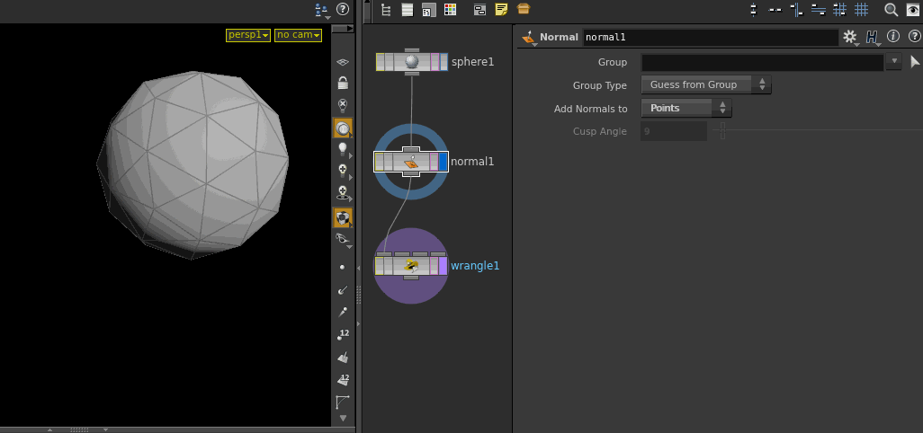

Don't judge or guess, visualise!
For normals, there's the ‘display normal’ and ‘display primitive normal’ buttons on the right side of the viewport. If you have other attributes, you can use the visualize sop (hotkey x) to display whatever you want, when you want.
Here I've used a normal sop to add point normals to the pig, and visualise them with the ‘display normal’ button. I then have an expanded version of the earlier code, this time with sliders to define both the spread and the vector to compare against.
