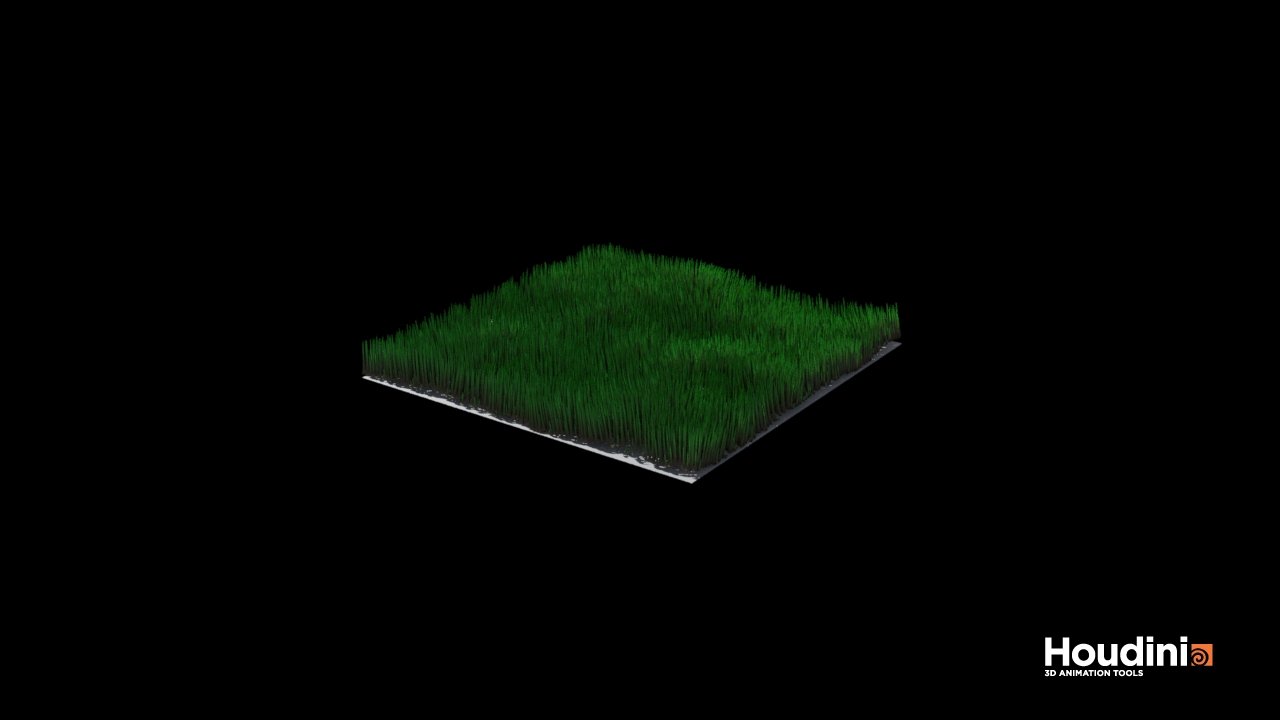

Well thought I would have a play with this. I made a point of not looking at Almina's node network and after completion mine looks very similar to yours. This is the copy stamp method, and for 10,000 blades of grass I think 10 seconds of stamping time is acceptable.
This is certainly not polished or anything and could be taken a lot further, but I gave myself a 30 minute window to play with.
NURBS curves rendered with the width attribute for Mantra. The attribute is controlled by a ramp parameter for customisation. Noise is added to the curves point position, colour is by a UV attribute on the curve itself, again using a ramp parameter.
Pretty basic stuff.
Was a fun little thing.
