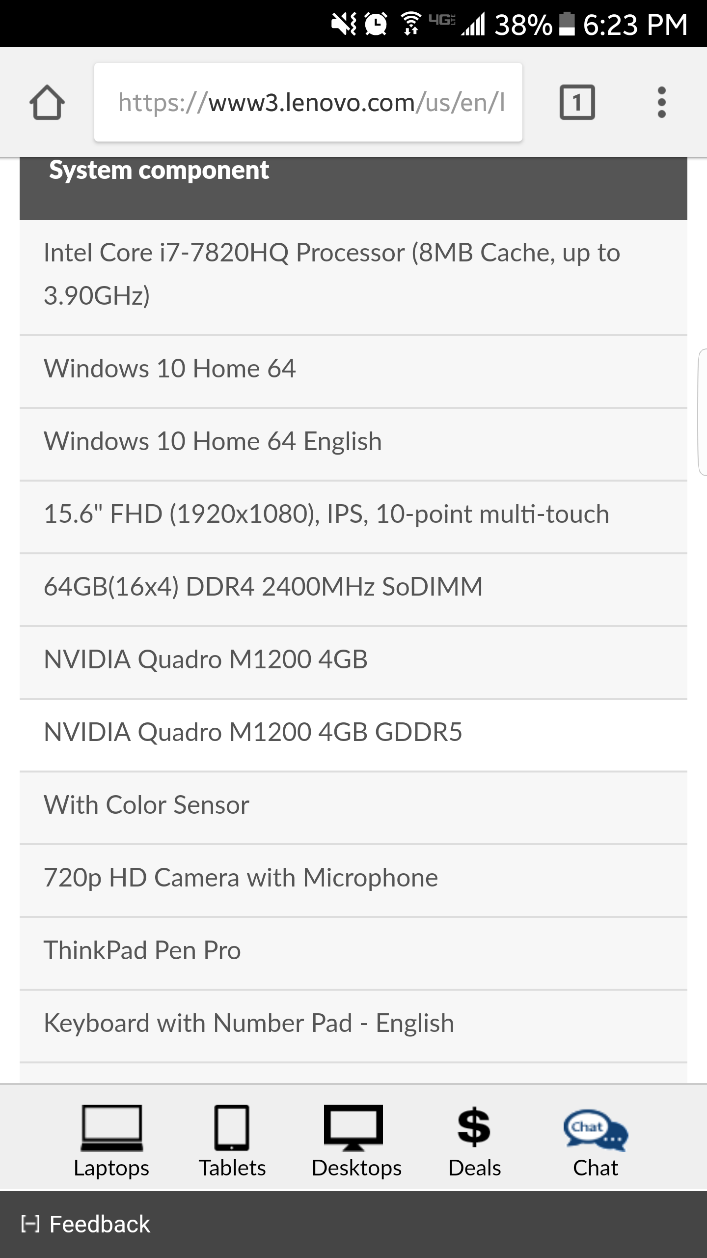

Attaching an image of the configuration I'm thinking about. The only thing this doesn't show are the two 1tb ssds I'm putting.
