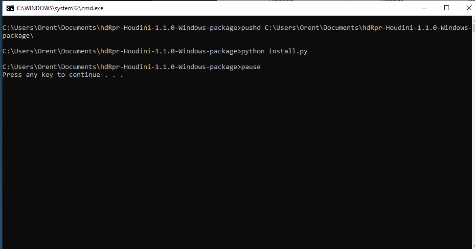

Nope. Should run without any other issues. So it doesn't show up in the delegates at all?
My only other thought is that it's not installing to the right location. We recently updated the release for macOS. Please try downloading the updated one from https://github.com/GPUOpen-LibrariesAndSDKs/RadeonProRenderUSD/releases [github.com]
It should say this when installing:
– Installing: /Applications/Houdini/Houdini18.0.287/Frameworks/Houdini.framework/Versions/Current/Resources/houdini/soho/parameters/HdRprPlugin_Viewport.ds
– Installing: /Applications/Houdini/Houdini18.0.287/Frameworks/Houdini.framework/Versions/Current/Libraries/libTahoe64.dylib
– Installing: /Applications/Houdini/Houdini18.0.287/Frameworks/Houdini.framework/Versions/Current/Libraries/libRadeonImageFilters64.dylib
If not can you file an issue on the github page?
