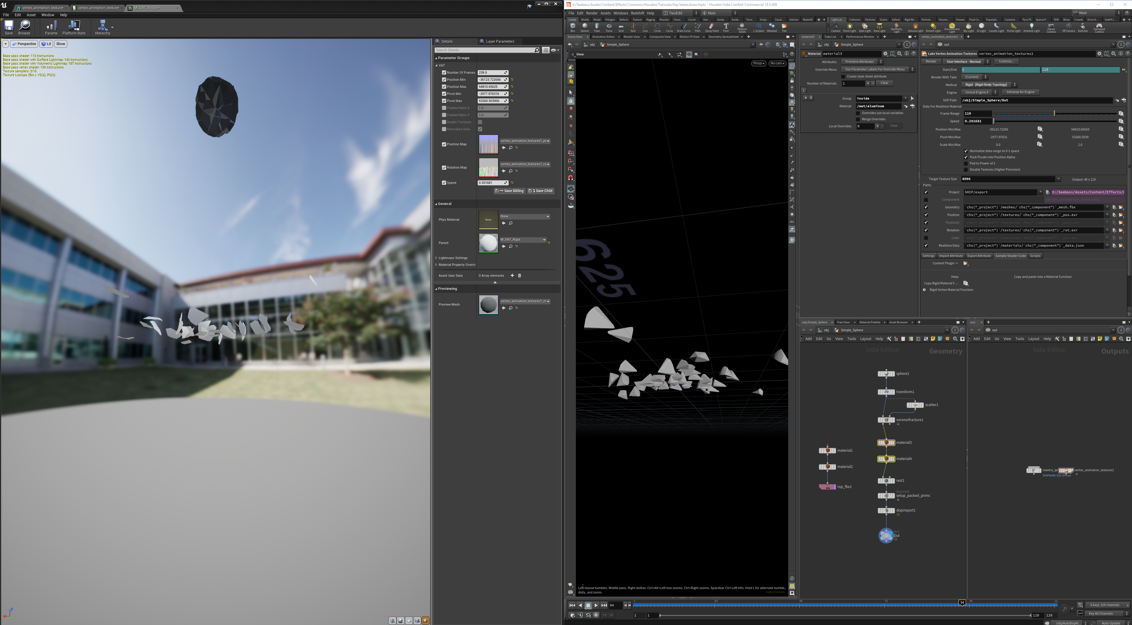

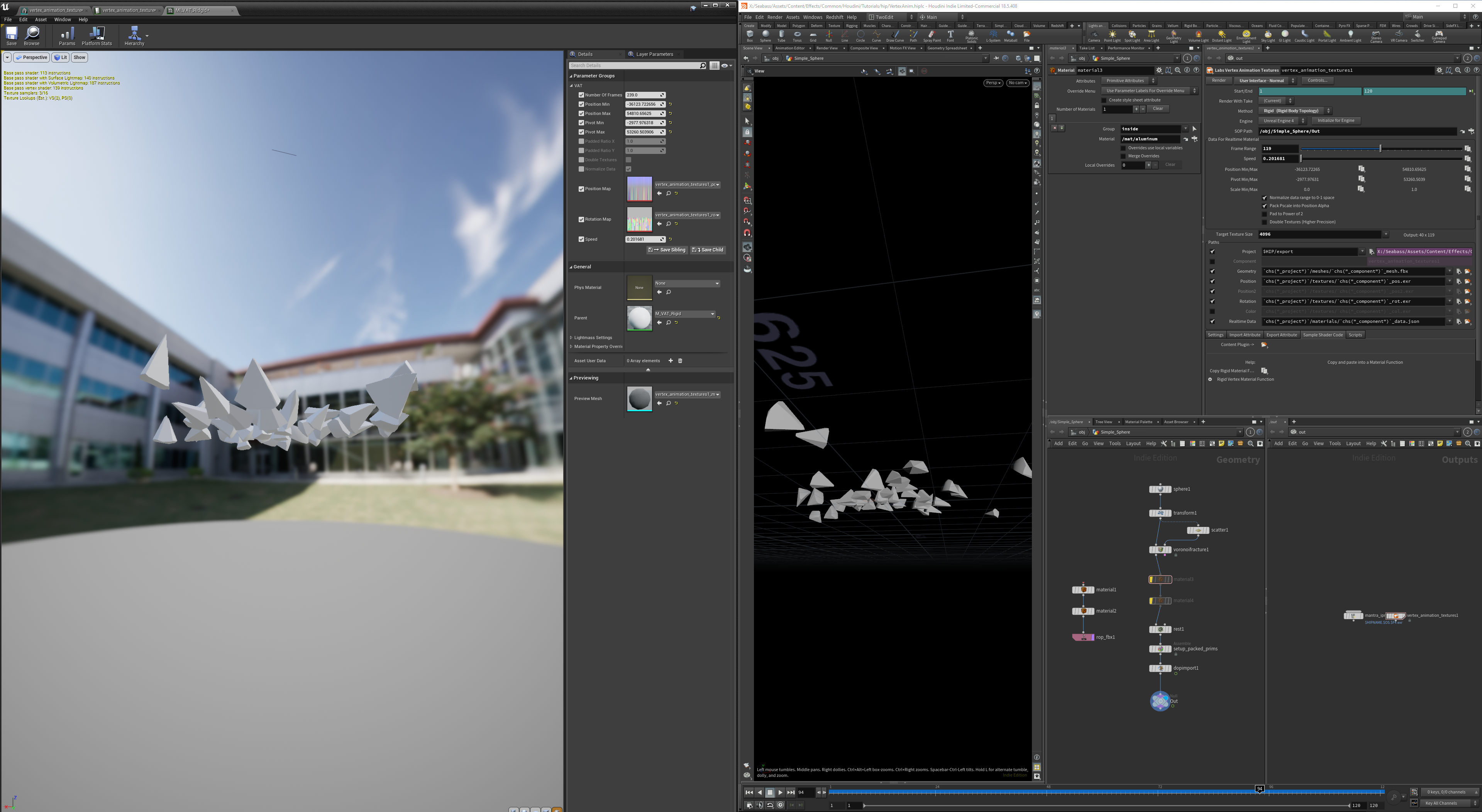

However, may be I have an issue with the “Pad to pow of2” function.
The “pow of2” version of VAT appears very flickering in UE4.
Is it normal or an issue?
When the compression setting of the pos/rot texture are set to “HDR(RGB, no sRGB)”, the symptom disappears.
I attache a movie of my case(the “pow of2”version on the left, the non-“pow of2”version on the right).
Cheers
VAT21_RBD_pow2_issue.mp4 (2.2 MB)
Have you set the padded ratio values? Does the flickering show up in the debug view in Houdini?

Yes the ratio values are correctly setted.
But for the debug view in Houdini, I cannot check them because it crushes when dived in.
To add, I also receive a warning message when opening the scene.
I attach the scene file, the capture of texture detail tab in UE4, and the log.
Cheers

Akira, it looks like that's a limitation of the compression setting. There doesn't seem to be anything wrong with the math when using pad to power of 2. I think you need to use HDR Compression.
The warning messages are from the way the geometry has been fractured. You probably have some very thin slices.

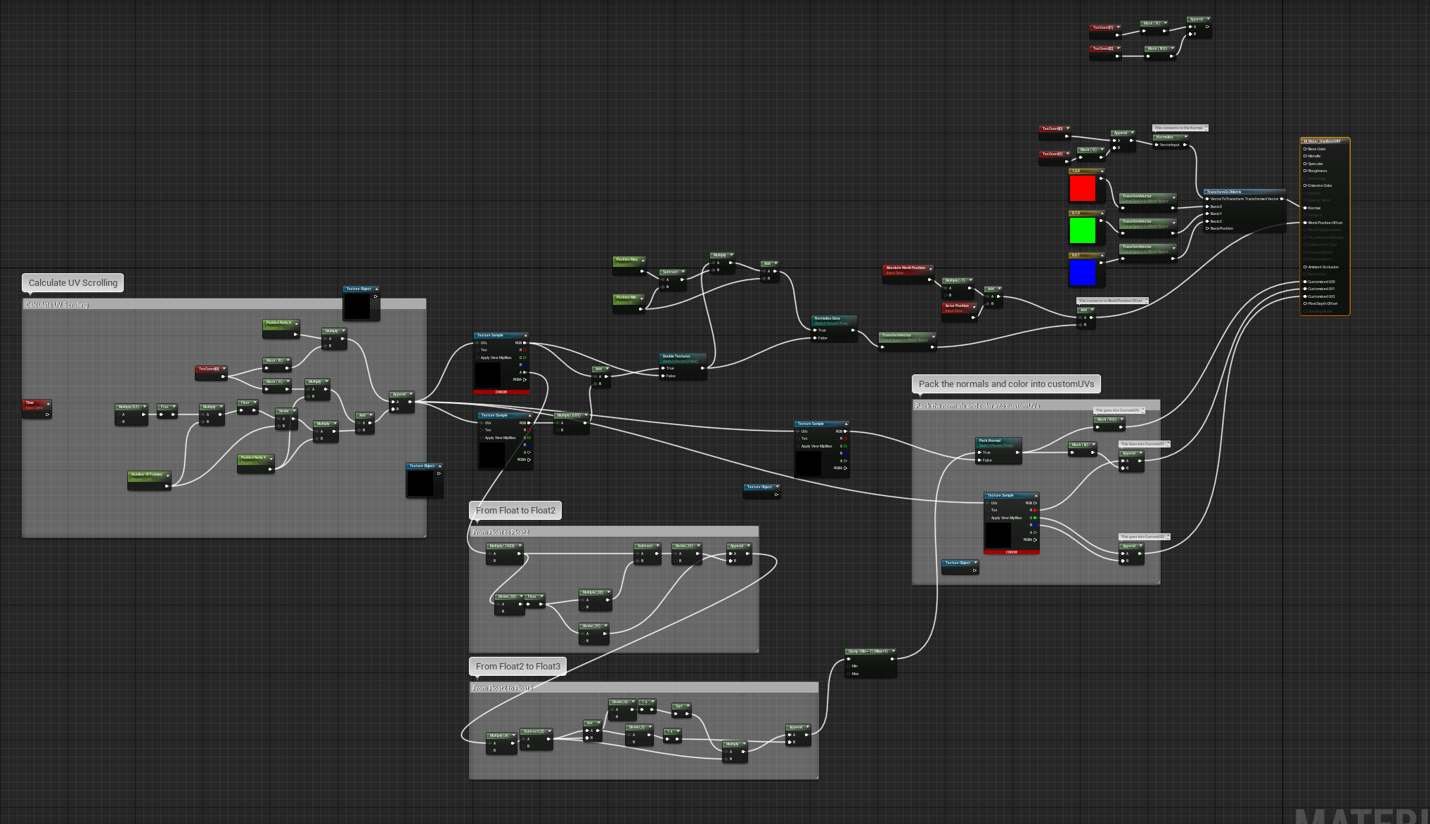

Hi Mike! I was comparing the new VAT material function with an old one from last year and was haunted by a couple of changes I couldn't understand… Do you mind explain them a little bit?
The first one is the subtract node appearing after the quaternion rotation:
It subtracts the rotated vector by the pivot value. This operation isn't in the old version. Does this mean that the info stored in the the position texture has completely changed meaning? Could you explain the decision?
The second one is this part right about the unpack pivot block:
They used to be something like this:
To me it feels like they should always give the same result… Is there anything I missed?
Thanks!
Edited by drewhong - Aug. 20, 2020 13:28:10
image (10).png (164.2 KB)
image (8).png (168.1 KB)
image (9).png (70.8 KB)
Joined: June 2008
Hey drewhong,
Basically the previous method was using a hack to get around how DOPs sets the pivot from the first to second frame of a sim. This worked most of the time at the beginning of the animation but the VAT result later in the animation would start to drift from the original. You could see this quite clearly with rotations.
In order to fix that I also had to change the order of operations to handle moving the object to the origin, applying the rotation, and then moving back to the current time's position.
So the new method is more accurate overall, but you might notice a slight break of an object after the first frame because of precision issues with the orient attribute in the texture.
Hope that helps.
Mike
