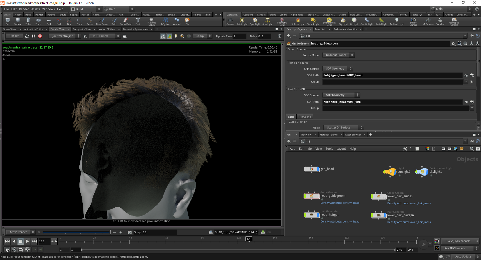

Hello Groomers,
I'm facing this serious issue time to time, while doing grooming in Houdini with continuous rotation in presp viewport somehow model started to look like this as a glitch or something. Please help if someone would like to.
Many thanks in advance. Cheers!!!

Looks like a clipping plane issue to me. The near clipping plane might be too far away from the camera clipping the geometry you are seeing. Houdini sometimes does not a good job of managing them.
To reset them leave the viewer state with “Esc” and then home your viewport by pressing “H”. Then recenter your camera on the object
Alternatively you can adjust these settings, which can be found when pressing “D” in the viewport.
