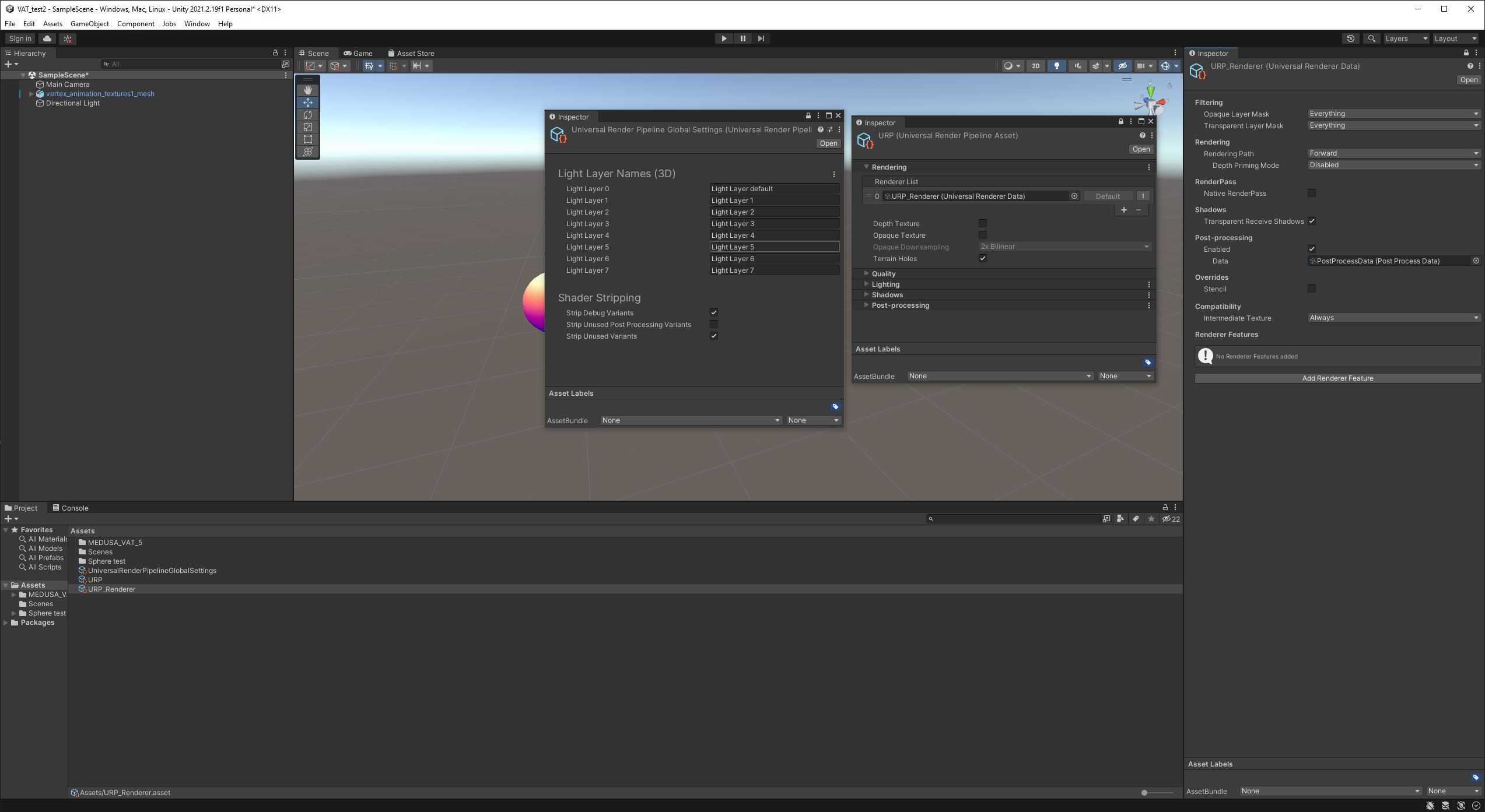

i just installed the newest version of unity 2022.10b2.2474 and imported my three folders (geo, tex, unity) from houdini. Sadly my unity material (in folder 'unity') appears pink. The shader is missinig? It sais: Hidden/InternalErrorShader. Could you help me?
All best and thanks for vat3.0, it seems to be supercool
dominik
PROBLEM fixed by myself
I missed to install the 'sidefx vertex animation textures' package in unity. Helpful is the the quick guide inside houdinis vat-node under tab 'realtime shaders.
All best.

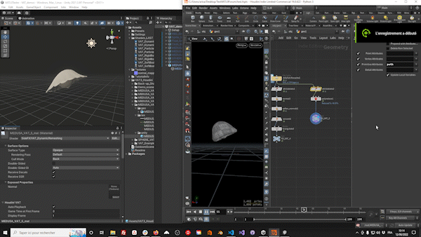

Hello,
I am attempting to use the provided VAT3_Tutorial_Simulations.hip with H19.0.455 to generate the cloth/soft body simulation and export to Unity URP 2021.2.5f1.
After setting up the Unity assets (mesh/textures/material) following the video instruction, the mesh appears black in the Unity viewport and does not animate. No errors are displayed in the console.
Any suggestions on how to proceed? Thanks!

Please go to the SideFX Vertex Animation Textures package folder inside Unity Editor and try saving one of the sub shader graphs (marked with SSG in their names). If you get an error, then it's related to this: https://www.sidefx.com/forum/topic/81422/?page=1#post-350762 [www.sidefx.com]
Edited by MaiAo - Jan. 10, 2022 18:36:49
- infinate
- 2 posts
- Joined: April 2019
MaiAo
Thanks for the rapid response. I did receive the error once I updated the shader asset. Look forward to updates!

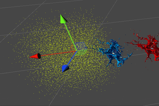

I I am trying to make Vat 3 work for almost a week now And nothing seem to work. I narrow down everything from Vat 2 2.1 to 3.
I use Houdini 19.0.507
I use Unity 2021.2.8f1
For a wild I tried my own simple Rigid simulation - not working I just tried to make Simon tutorial to work( and it does not)
rigth now it look, like cluster of thing.
I want to say I do not get shader error, so it work theoricly.
someweird science is going on here.
https://media.giphy.com/media/JQiKSufnq7P3piV40i/giphy.gif [media.giphy.com]
I mostly know to debbug my stuff but this hell no.
I would really need some help please.
