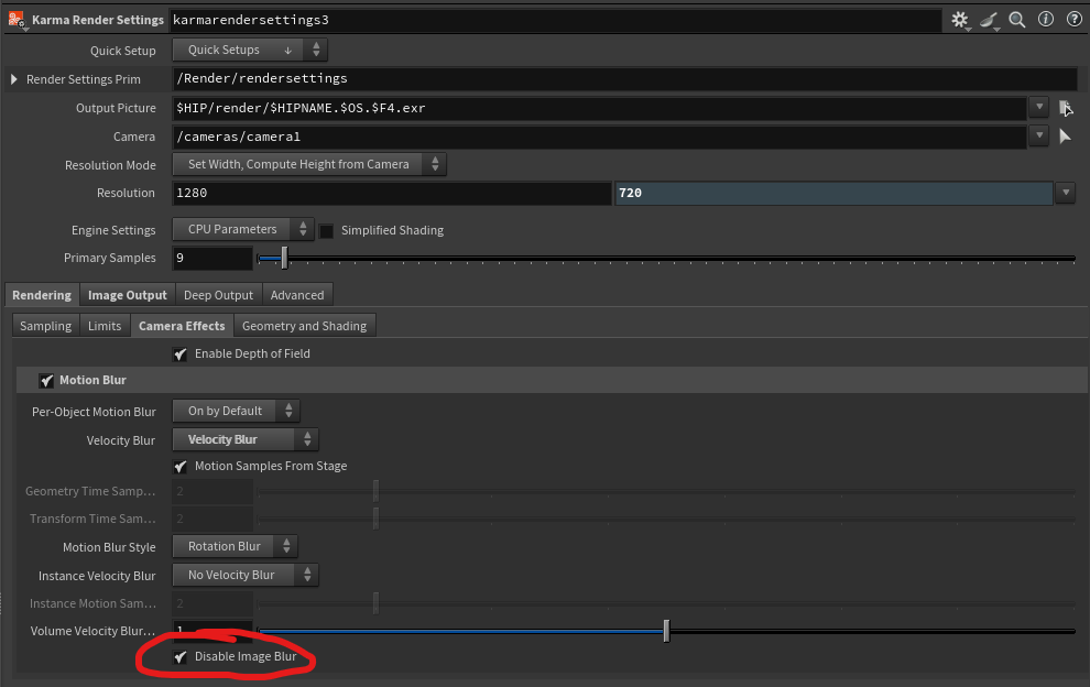

On the Karma Render Settings LOP node, if you turn off Rendering > Camera Effects > Disable Image Blur do you get the expected motion blur?
Are you rendering with XPU or CPU? Only CPU has motion vectors supported at the moment.
Here's a hipfile that shows it working.
MotionVectors.hip (531.7 KB)
Joined: May 2015
I think I have a related problem. When I turn on motion blur (velocity) in Karma render settings and turn on Disable Image Blur, when rendered the geometry shifts towards motion blur direction. When Disable Image Blur is turned on it renders as expected. If I do not turn on motion blur, I do not get any velocity or motion vector AOVs, they come out blank. Tried it both on CPU and GPU and in both cases its the same. I'm on 20.5.278 right now.
