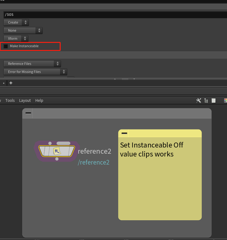

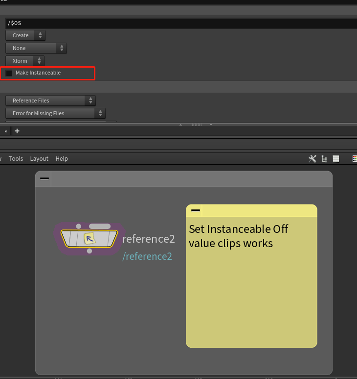

oh,by the way,if i reference a asset and set (make instanceable) on, value clips dosen't work,so i have to set instanceable off.
i known this uses more memory.
so,instanceable primitives and value clips dosen't work together,right?

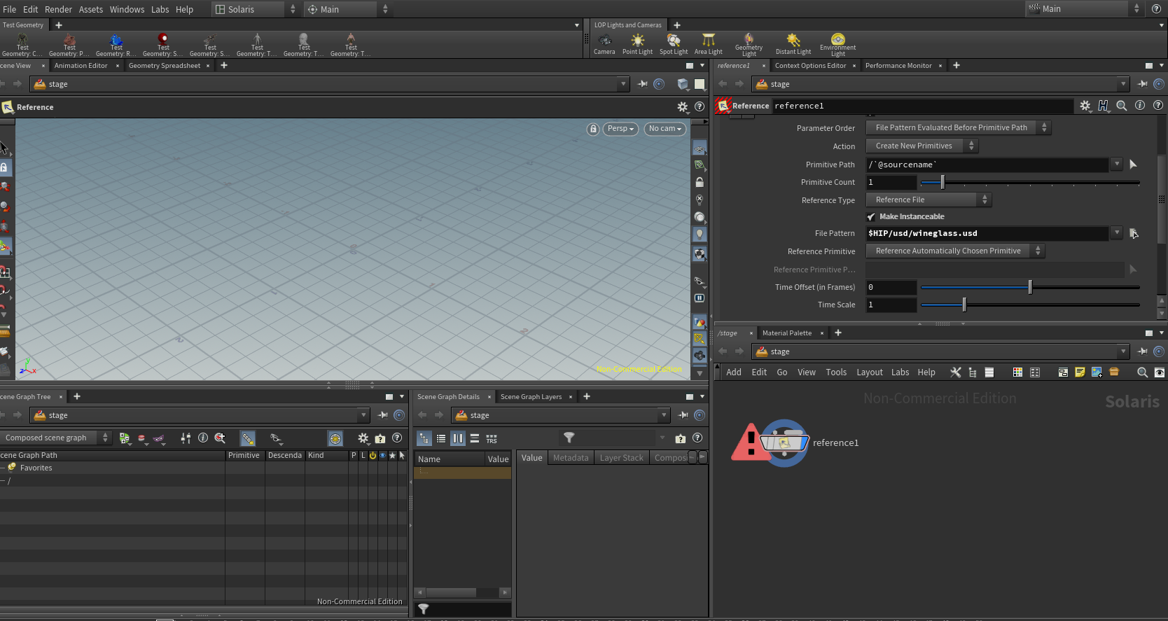

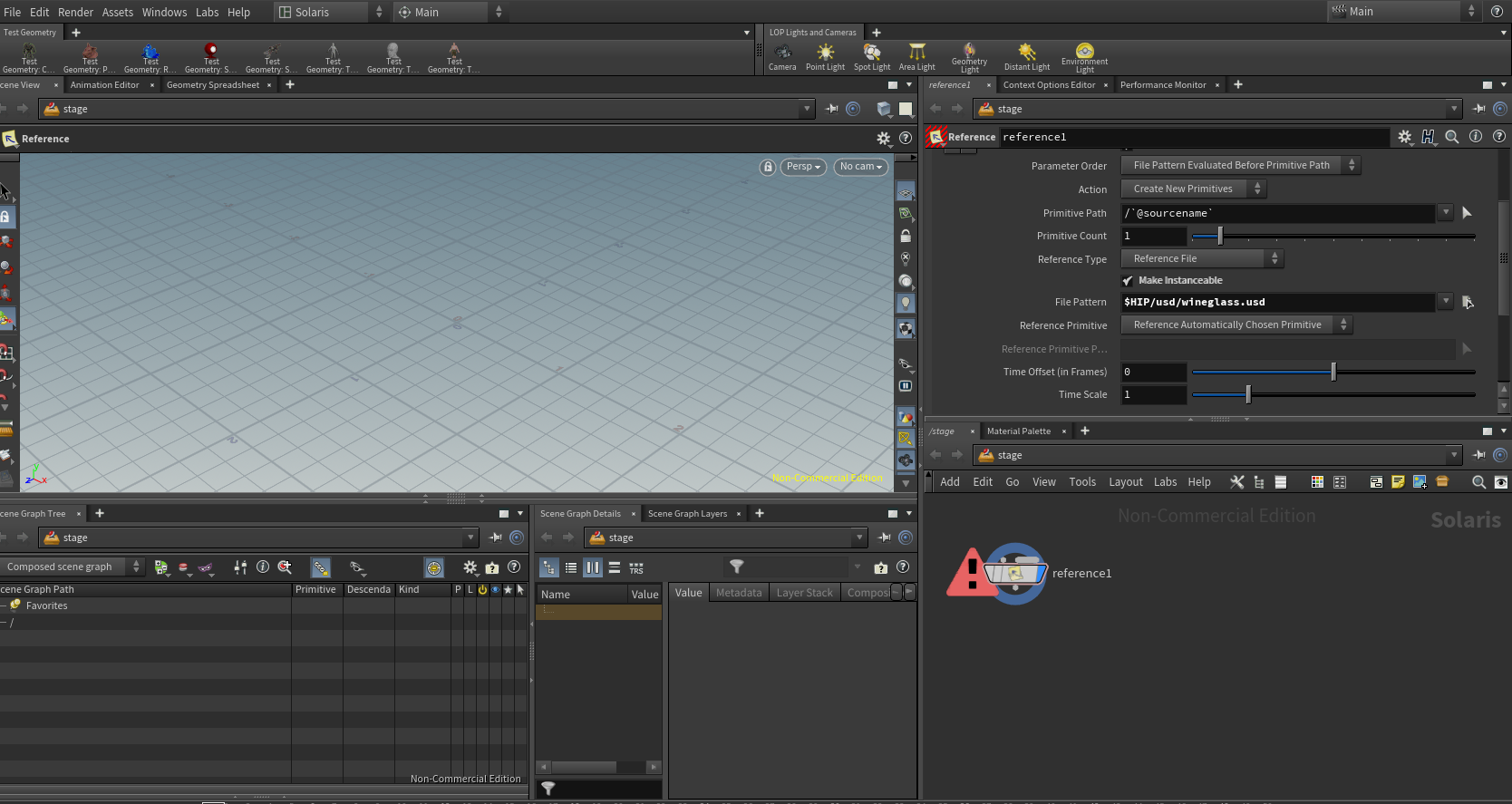

last problem is about valueclips node in LOP(see the third picture)
i don't known if this is normal?
