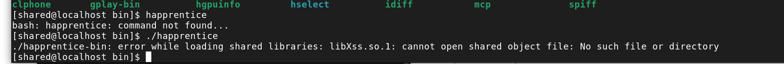

Edit: scrolling though my command history it looks like I also ran this line but I dont' recall if these were installed by default
I had to dive into all this rocky 8 stuff too recently, on a cloud virtual machine for added fun.
After getting nvidia drivers, teradici, workstation, kernel updates etc all going, houdini would fail at start complaining about a missing X library.
Some of the packages mentioned earlier in this thread would let me install them, but others claimed they couldn't be found. After much running around, I found simply doing a...
dnf update
....seemed to find all the things Houdini was missing, and it starts fine now.
