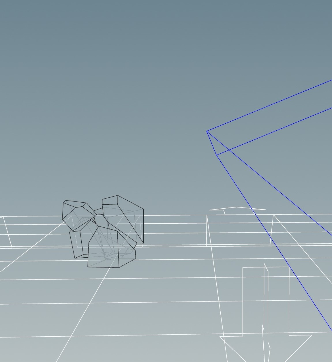

AndyWWhat platform are you on? The hipfile I posted should definitely break on the second impact. Here are frames 30 and 50 of the sim.
The hip file you posted doesn't break on the second impact when I run it, I'm on H19.5.303 . Here's my test setup
In your setup, you're setting the strength to 0 on frame 25 which would be almost the same as simply deleting all the constraints at frame 25.
Here's a hipfile with a few options that show how you can control the breaking explicitly.
