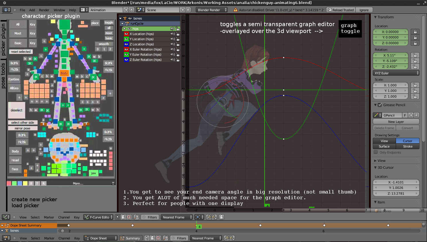

If there is "skinned geometry" how about morph targets? are they also stored in APEX framework?
also is it possible to store bones for facial rig there?
i hope that in future APEX will use ML so animating and setting poses will be easy. somethink like in Cascadour whith autopose turned on.
ah i assume that APEX is multihreaded?
