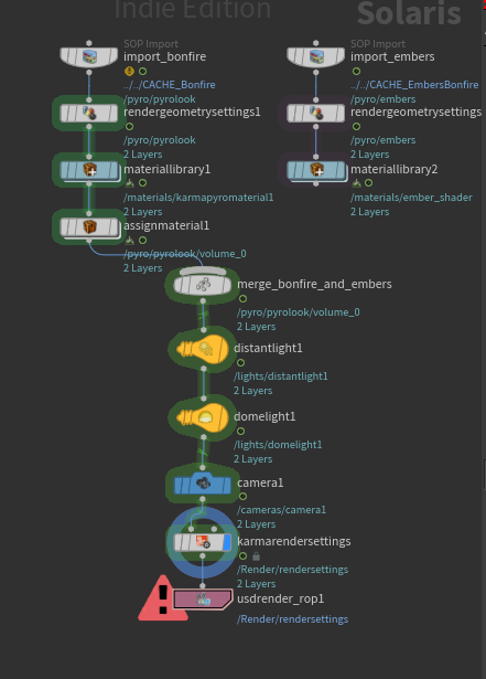

Ya getting the same issue on Karma CPU and XPU.
I am attaching screenshots of both cases with the same karma pyro material.
The AOVs render blank. If you connect them to a collect however, it only renders the scatter AOV and nothing else.

attaching the file as well. Its a Simple Shelf Bonfire.

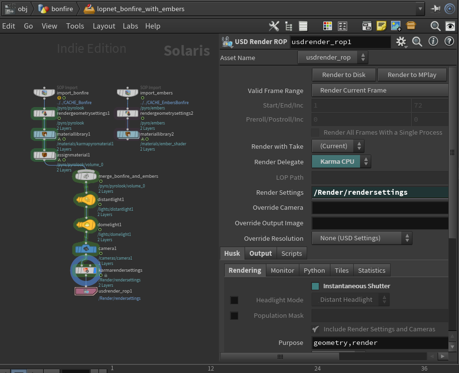

Okay try these steps, I've done it using a simple Bonfire Shelf and Karma Pyro Material. I have not hand-placed any of the Karma AOV nodes (its as default) to test.
As per the help, from what I understand, the Create Render Vars Toggle on the Karma AOV nodes should be doing these steps in the background but it doesn't seem to be working. This quick fix might help and it seems to work in both CPU and XPU.
