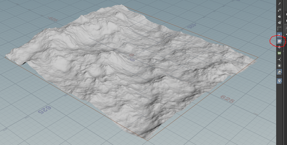

Joined: May 2020
Not sure if this is the exact issue everyone was having, but when first adding the heightfield node it was displaying as black and unusable. I found out that I had "Show UV texture when UVs present" turned off and after turning it back on, everything worked as expected.
82 posts
Joined: May 2013
Ahh brilliant - I'm sure that was never the case before and it must be a bug but yes that does work! Thanks very much for the tip!
