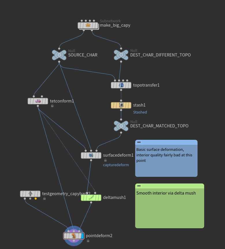

Here's an idea for this.
You use topo transfer to match up the surface topologies.
Generate a tet mesh for the original character. Deform the tet mesh to the new character using Surface Deform. This preserves the surface of the tet mesh very accurately, but doesn't do a great mesh on the deep interior.
To solve this you can run delta mush on just the interior points. This should leave the surface untouched but smooth out the interior deformation.
The resulting tet meshes can be used to deform any muscles, for example via point deform.
See example file which transfers muscles to a Capy with different topo, pose & bigger belly.

Why Surface Deform instead of Point Deform in this case?
- KaiStavginski
- 659 posts
- Joined: Aug. 2013
I think they're mostly interchangeable in this case. But since at that step we care mostly about accuracy at the surface, surface deform does the job - and with less parameter tweaking. Interior deformation might be worse than Point Deform, but whether you use Point Deform or Surface Deform, they really just serve as the intitial input to delta mush and don't have a massive impact on the output.
You'll have to weigh the pros and cons, Point Deform might work better in some cases.
