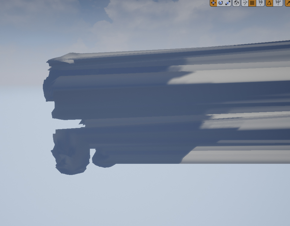

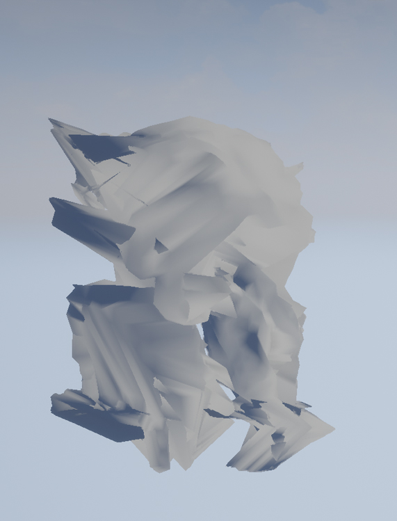

Hi. Same problem here.
I did test FLIP sim, with version 16.0.531 it looked like on fig. 1 (exploded vertices)
With asset in your post it looks like in fig. 2 (normals looks broken)

Hey Ilya,
That's getting closer, make sure that the setting for packed normals on the shader, match what your setting is in Houdini. We have an optimization to pack the normals into the alpha of the position texture, but if you export the normals it should be off.
Clinton,
Try the unreal code from the new HDAs, they are commented a little bit better. You have a couple of nodes that aren't wired to the proper place.
Let me know if those things work out
Luiz
