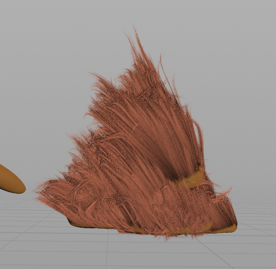

Is it possible to get the Houdini scene file for the first part of the tutorial (Rubber Toy) as I am working on fur dynamics and finding it hard to control and get the wind effect on our model. More insight on Fur dynamic will be much help.

No problem - here's that rubbertoy scene.
I disabled some file caches to makes sure there are no external dependencies.
You should run the two File Cache SOPs in /obj/blob_geo/sim. These are for the FEM simulation and for generating the deforming collision VDB.
rubbertoy_fursim.hip (1.9 MB)

thank you very much, thats exactly what i was looking for.

Thank you Kai, it helped a lot.
