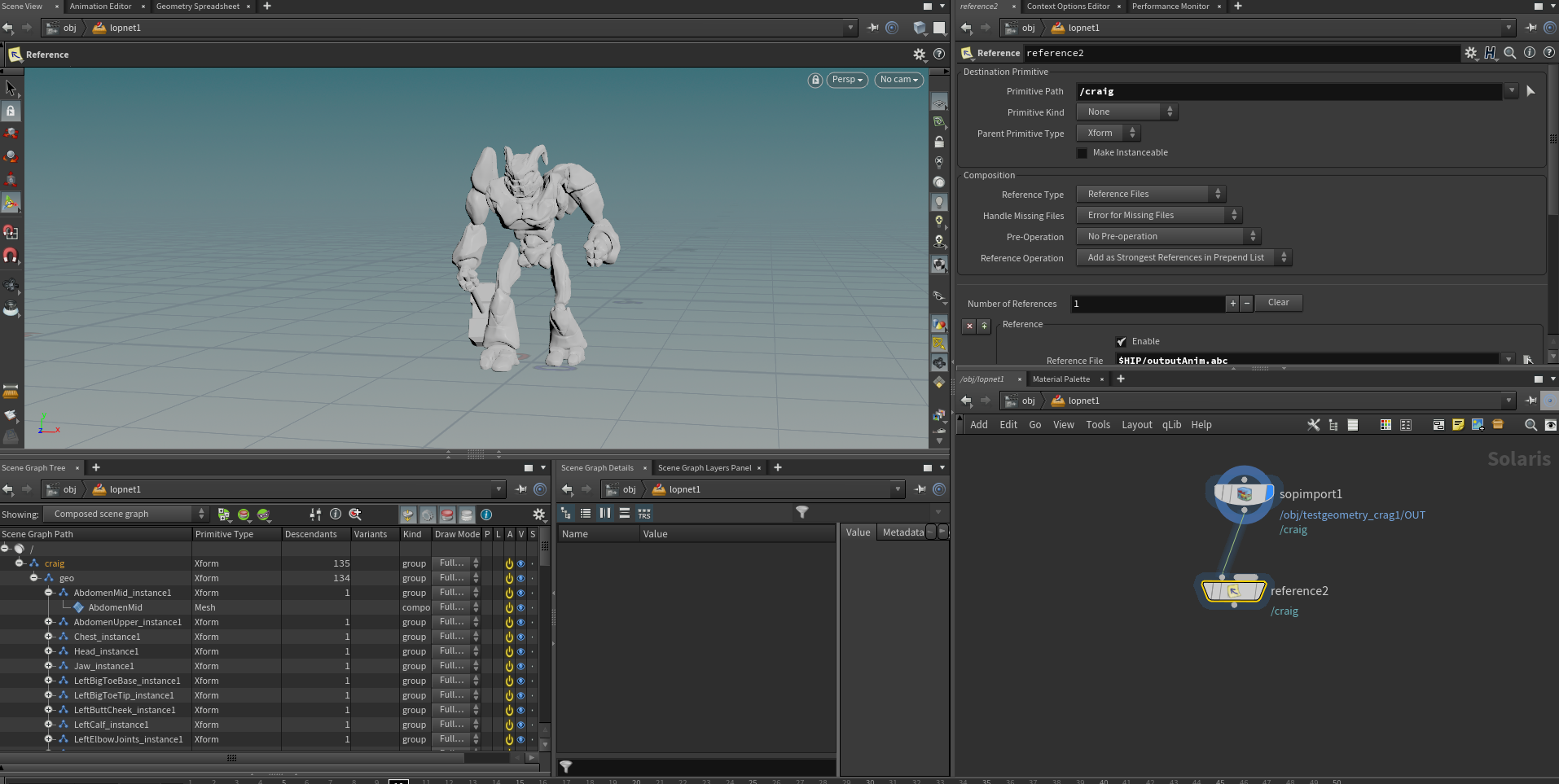

For alembic, there's no need to import into /obj first.
Alembic are first class files that can be sublayered and referenced just like usd files.
For a camera, I recommend referencing the root prim of the camera in the alembic archive if there are other objects in the alembic that are not desired for rendering.
If the entire alembic hierarchy is desired, it can be sublayered in.

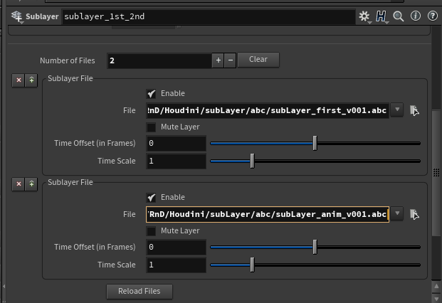

- Noboru Saka
- 14 posts
- Joined: July 2013
thanks alot,
it's very simply way to best!
i got inspires from your advice.
sublayer composit multiple alembic,
insert static alembic has some attributes (ex.uv) into slot 1,
insert animate alembic has only points aniamtion into slot 2,
output animate mesh has some attributes, same attribute override by what come later.
Exactly USD.
this technique brings minimal data space on disk.
nice.
thanks
Exactly USD.
nice.
thanks

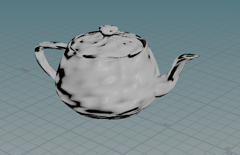

Noboru SakaHi, I would like to replicate your workflow but I'm having some trubles, when I plug the transforms the shapes are going a little bit crazy as you can see, how did you do it? Could you upload a simple scene that I can take a look at?

I've attached both a screenshot and the scene, I'm really stuck on this, when you've got a sec could you please take a look at it?

perhaps
you need turn on into "Unpack_USD_Prim_to_Polygons"(sopModify(LOP))
https://www.sidefx.com/docs/houdini/nodes/lop/sopmodify.html [www.sidefx.com]
geometry are packedPrimitive in LOPs

I'm unpacking it inside the SOPmodify with unpack usd, my question is what "Edit Root Layer" is doing?
If I keep "Edit Root Layer" ON, The anim works but the Position of the points goes back to the Initial state but not the normals
If I keep "Edit Root Layer" OFF, everything works but I don't understand why?
This is the scene updated with that SopModify
