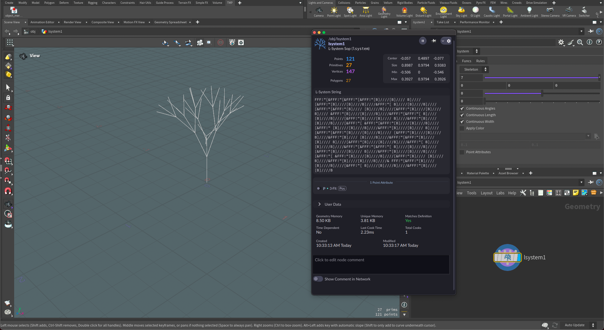

To ensure my criticism is grounded with examples: the middle mouse dialog serves as another instance of poor interface design from multiple angles.
The mission impossible: To design an interface that shows zero useful information yet occupies the entire vertical space of a 4K monitor.

My assumption was that their focus was on the technology backend rather than the front-end. To save recipes, they created new API calls to capture all the parameters, which was not possible before. A similar approach was taken with shortcuts, using a new JSON format for keymap overrides. This is a positive step, but it usually has many implications and requires extensive testing, which likely didn't happen.
Regarding the UX, they lack a coherent strategy and make strange decisions that result in an interface that looks worse than one from 20 years ago, which they haven't updated in ages. It's best to hope they don't make further changes.
To avoid being overly critical without examples: the middle mouse dialog is a complete disaster from many perspectives. They would be better off leaving it untouched.
The mission impossible: To design an interface that shows zero information yet occupies the entire vertical space of a 4K monitor without fitting to the vertical space,
That’s interesting. I mean other than a few cosmetic things - font and alignment choices - I love the new MMB panel. It’s look though doesn’t seem to fit the rest of the Houdini at all.

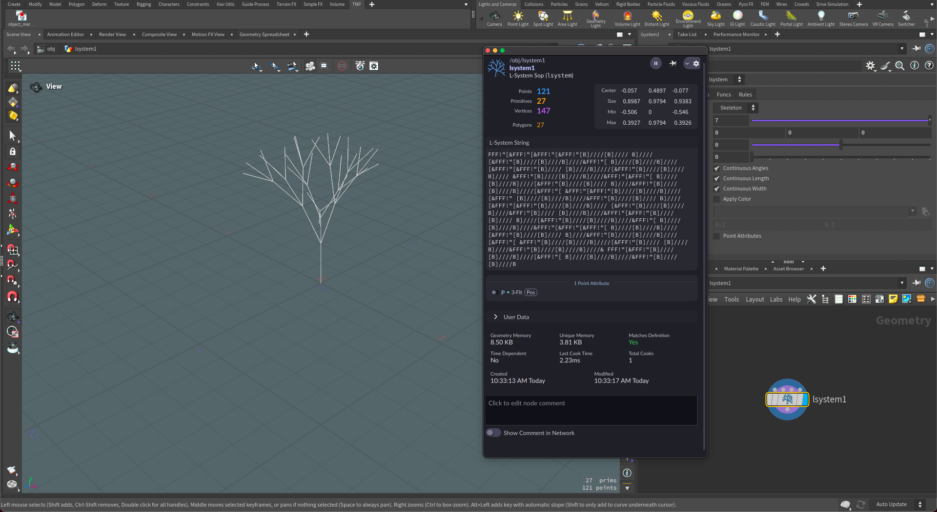

I would love to like it, but I have a few concerns:
1. Why does it look different in various contexts? For instance, why does the new Copernicus use the old version instead?
2. Why doesn't it handle basic cases, which I encountered within just five minutes of use (see the screenshot above where panel doesn't show any useful information but utilizes a lot of screen real-estate)?
3. The typography looks bad because:
  • The use of progressively smaller text to distinguish information disrupts readability. Previously, color was used for this purpose, which was more effective.
  • The use of similar text styles for opposing elements disrupts the hierarchy. For instance, they apply the same style to both the header and the subtitle of the value.
4. The alignment is very chaotic, with one, two, and three columns and some additions that break the columns, making information consumption harder.
5. The scrollbar appears all the time where in 90% of cases there is nothing to scroll
To me, this appears more like an unfinished prototype than a production-ready feature.
